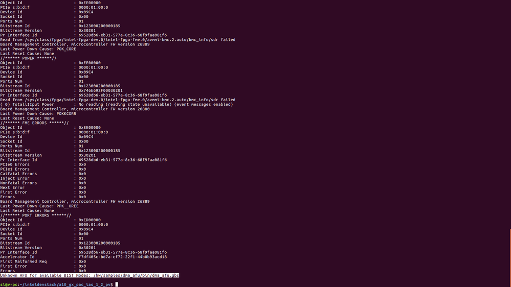

Well, the new problem is when I moved on to the next part, Running FPGA Diagnostics, in the user guide and run the command sudo fpgabist $OPAE_PLATFORM_ROOT/hw/samples/nlb_mode_3/bin/\
nlb_mode_3.gbs it gave the result of Unknown AFU for available BIST Modes: /hw/samples/dma_afu/bin/dma_afu.gbs rather than the sample output.What does this mean? Was I missing something?
