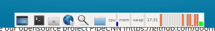

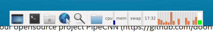

      Our inhourse project has a much bigger longer runtime when using the new emulator. The project uses several autorun kernels, I susbect the autorun kernels caused this problem. I have captured the CPU utilization as follow. You can clear see there is a big difference: the legacy emualtor uses more threads compared to the new one.
      1. emulaor v19.3 (new emulator)
      2. emulator v19.1 (lagecy one)
