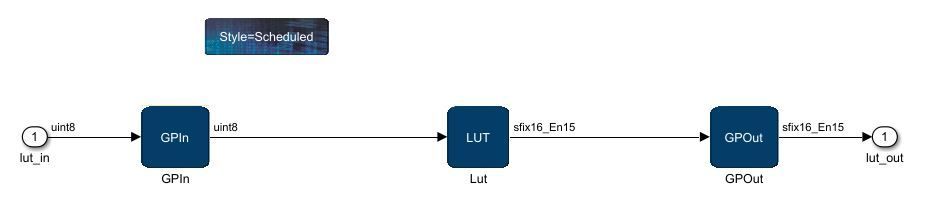

    If this is a standalone LUT (assuming part of a bigger design) - try bookending the LUT with GPIn and GPOut blocks and drop a SynthesisInfo block. In this case, latency=0 - true lookup table / not registered - and it did build fine in Q18.1 w/ R2019a.
    In this case, lut_values is designated as the contents in the LUT block.
    From setup .m file:
    lut_values = zeros(1,16);
    Jeff
