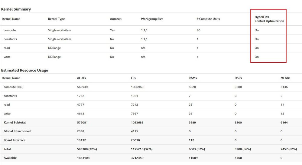

@MeiYanL_Intel That is not true, the HyperFlex optimization already existed in v18.1.x (and maybe even before that); it just had a slightly different name. Please check the attached screenshot from the HTML report of a test compilation using Quartus v18.1.2 against the s10_ref BSP:
