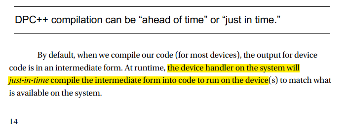

    This picture is from the book: https://www.apress.com/us/data-parallel-c-advanced-chapters-just-released/17382670
    On the cloud, I will try Ahead-Of-Time compiling, as suggested in here: https://software.intel.com/en-us/oneapi-dpcpp-compiler-dev-guide-and-reference-ahead-of-time-compilation

    Hi again, it seems like ahead-of-time compiling drastically reduced our run-time performance for the device. On the other hand, it increased the host execution time..
    This is the result for AOT compiling:

    And this is the result for JIT compiling:

    Did I skip something here? We increased the device kernel exec performance but why the host performance (Scalar exec above) is suffering now?
