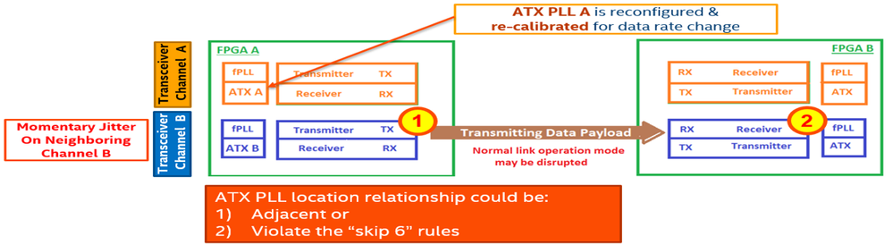

During an ATX PLL user re-calibration process in an Intel® Arria® 10 device, there will be momentarily increased TX jitter and BER risk on the neighboring channel. The ATX PLLs placement location that violates the "skip 6" ATX PLL spacing requirement rule indicated in "Intel® Arria 10 Transceiver PHY User Guide" will observe this failure. The primary application and protocol that might be impacted is the OTN protocol.
By referring to the example diagram below, when ATX PLL A is being re-calibrated, there will be a risk on the neighboring channel that is clocked by ATX PLL B, which is in normal data transmission mode (user mode):
- Neighboring TX channel with momentary increased TX jitter.
- BER risk on the far end neighboring RX channel.
