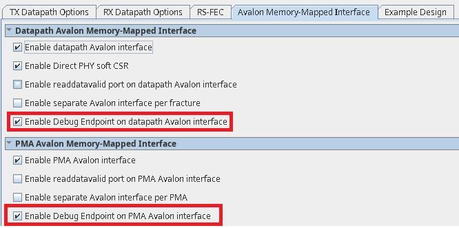

Due to a problem in the Intel® Quartus® Prime Pro Edition Software version 21.2, the F-Tile PMA/FEC Direct PHY Intel FPGA IP Debug Endpoint on Datapath Avalon Interface and Debug Endpoint on PMA Avalon Interface are not working.
If you enable these two Avalon Interface options in the F-Tile PMA/FEC Direct PHY Intel FPGA IP, you will not be able to read/write and access to registers stored in the reconfiguration space of the FEC and the PMA interface block and the PMA.
