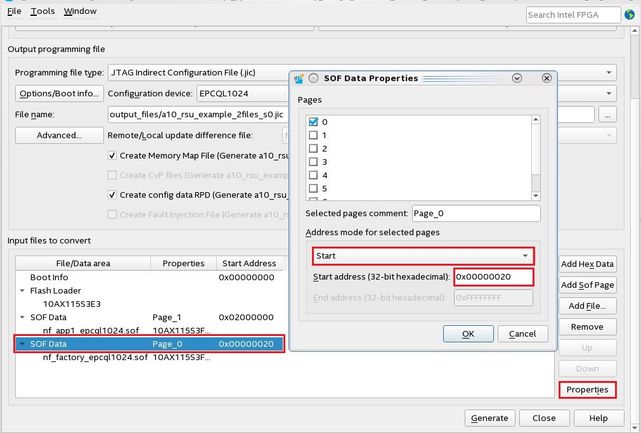

After adding the factory configuration image .sof in the Convert Programming File tool, follow the following steps to manually set the start address of the factory configuration image:
  1. Under Input files to convert, select the SOF Data  Page_0 row where the factory configuration image .sof is attached (See Figure 1).
  2. Click the Properties button to open the SOF Data Properties window.
  3. Under Address mode for selected pages, select Start.
  4. In the Start Address field, input 0x00000020.
  5. Click OK.
Figure 1: SOF Data Properties
