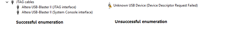

Below is an example of a successful and  an unsuccessful enumeration as seen in Windows* 10 device manager:
