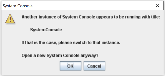

Why does a dialog box pop up stating “Another instance of System Console appears to be running with title: SystemConsole” when relaunching the F-Tile Transceiver Toolkit in the Intel® Quartus® Prime Pro Edition Software version 22.1 for Windows OS?
Description
After exiting the Transceiver Toolkit and then relaunching it, a dialog box pops up stating “Another instance of System Console appears to be running with title: SystemConsole”. The device also can’t be reprogrammed over JTAG unless the board is powered down and turned back on.
This happens due to the process “quartus_py.exe” not being terminated properly upon exiting the System Console.
