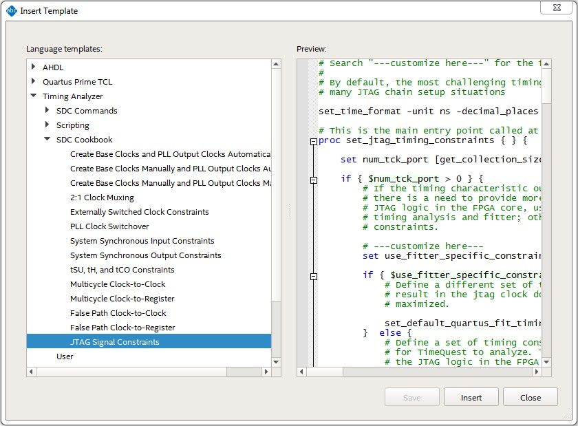

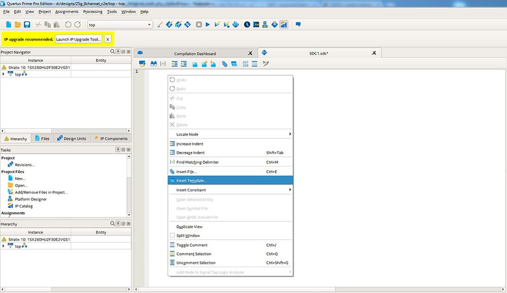

Alternatively, you may wish to be more accurate and manually constrain the JTAG clock. To do this use, Quartus provided an SDC timing template.
- Open the SDC file with Quartus Prime Pro Edition ( File -> Open )
- Right-click in the SDC file window to pop up the menu
- Select 'Insert Template
(4). Select 'JTAG Signal Constraint' to insert constraints to the SDC file.
