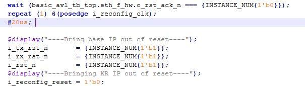

  1. )    Navigate to <your_design_path>/example_testbench folder
  2. )    Open “basic_avl_tb_top.sv” testbench file
  3. )    Add ~20us delay for the de-assertion of "i_reconfig_reset" as shown below
  4. )    Run the simulation as explained in the Design Example User Guide.
