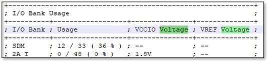

If the VCCIO of any unused HSIO bank is assigned to 1.8V, the Quartus® fitter report will incorrectly reflect the 1.8V VCCIO Voltage for this unused bank.
If a used HSIO bank is assigned to 1.8V, Quartus® Prime Software will detect conflicts between the VCCIO assigned in the used HSIO bank against the VCCIO of the valid I/O standards selected for the HSIO pins. The Quartus® Prime Software will display an error similar to the following example:
