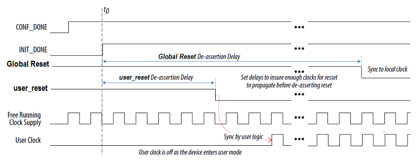

To prevent this event, Intel recommends that you build a design using the User Reset and Clock Gate Intel Stratix 10 FPGA IP with your own user logic to un-gate the User Clock and de-assert the Global Reset signal as shown in Figure 1. Use the User Reset and Clock Gate Intel Stratix 10 FPGA IP core to de-assert the signal from the user_reset port to un-gate the User Clock. Then build your own logic to de-assert the Global Reset signal after you have un-gate the User Clock.
Note that the Free Running Clock is an externally sourced clock, whilst the User Clock is a clock that clocks user logic in the FPGA. The User Clock could also be a free running clock or a phase-locked loop (PLL) generated clock.
It is expected that only a single IP instance is required to ungate all user clocks, whilst the global reset signal should be used to release/de-assert the reset in multiple domains. If the design has multiple reset domains, ensure the global reset signal is held long enough for the signal to propagate to all the domains before de-asserting it.

Recommended de-assertion delay for user_reset signal using the Intel Stratix 10 FPGA User Reset and Clock Gate IP and the de-assertion delay for Global Reset signal
The user_reset signal de-assertion delay must be more than one User Clock cycle. You can get the desired delay by entering the De-assertion Delay value in the User Reset and Clock Gate Intel Stratix 10 FPGA IP. The possible values for the De-assertion Delay parameter in the User Reset and Clock Gate Intel Stratix 10 FPGA IP can range from 0 ns to 65,535 ns. You must build a synchronizer using standard anti-metastable technique inside:
  1. The User Logic to Ungate User Clock to synchronize the user_reset signal with respect to the free running clock.
  2. The User Logic to De-assert Global Reset to synchronize the user_reset signal with respect to User Clock.
The Global Reset signal de-assertion delay must be long enough for the Global Reset signal to propagate to the global reset logic in your system after User Clock is running. Build your own user logic to de-assert the Global Reset signal after user_reset is de-asserted and User Clock is running. You must also synchronize the Global Reset signal with respect to User Clock using standard anti-metastable techniques.
Figure 2. User Reset and Clock Gating Timing Diagram
This information is documented in the latest Intel Stratix 10 Configuration User Guide for Intel® Quartus® Prime Pro Edition Software v19.1.
