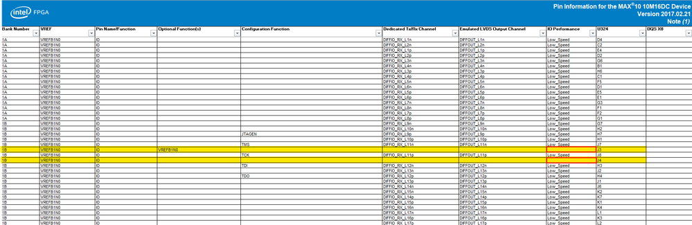

No, due to a problem in the pinout files for all MAX®10 FPGA devices, information on IO performance for Single-Ended pins is not available.
Example of Existing Pinout Files

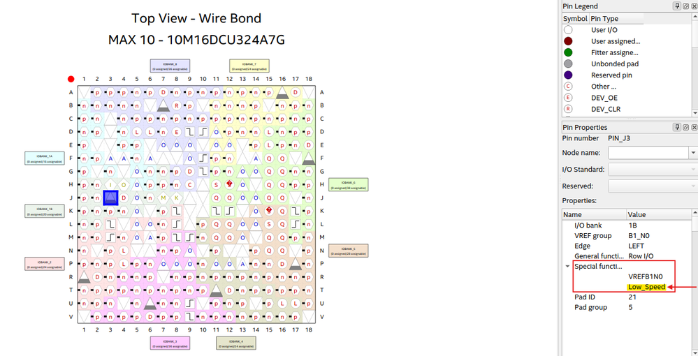

To work around this problem, refer to the Pin Planner -> Pin properties -> Special Function in Quartus® Prime Standard Edition Software for MAX®10 FPGA devices. This problem is scheduled to be fixed in the pinout files in a future release of Quartus® Prime Standard Edition Software.
Quartus® Prime Standard Edition Software Pin Planner Targeting MAX®10 FPGA device
