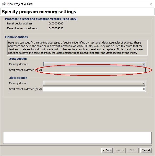

First of all, if I build the system with SOPC Builder and I use the PTF file in Altera Monitor, I cannot select the memory devices any more, thus I cannot complete the configuration...
... and I cannot even think of completing this task.

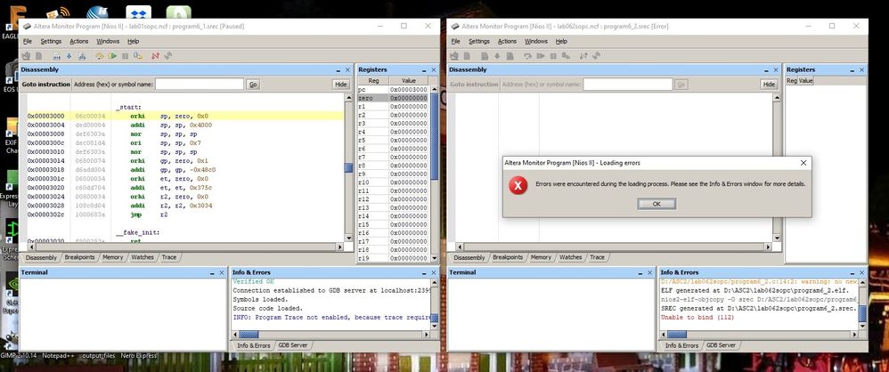

If I use the SOPCINFO file instead of the PTF file, then I can select CPU1, MEMO1 and program1 for the first instance, and CPU2, MEMO2 and program2 for the second instance. Both programs can be compiled correctly, but only one of them can be loaded and run, and the attempt to load the other one fails.
OK, I disconnect the first instance and manage to load the second program, and now the attempt to load the first program fails.
In both cases I get the error message "Unable to bind (112)".
