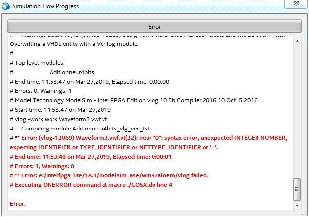

Look please at the below screenshot :

"this time the execution has progressed but it displays the following message"
That`s nice, now error is at line 32 of Waveform3.vwf.vt, open that file & try to debug the issue.
If you provide your project(Project->Archive Project) that will be easier to others to support.
