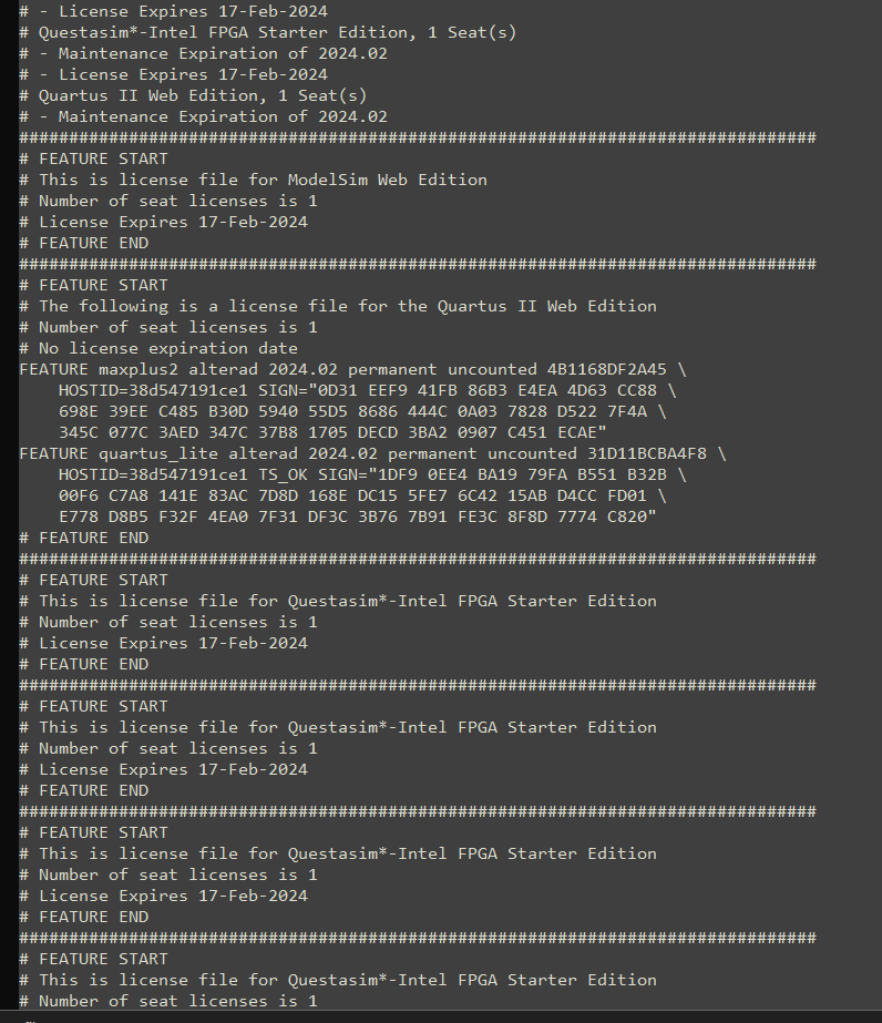

    • GR1's avatar
      GR1
      We have tried and it still generated only the licence for Quartus...see the attached screenshot... 
  • AR_A_Intel's avatar
    AR_A_Intel
    Hi
    Could you help to request only Questa Sim Starter Edition free license
    Here the step
    https://licensing.intel.com/
    1) Go to Sign up for Evaluation or Free licenses
    2) Select Questa*-Intel® FPGA Starter Edition SW-QUESTA
    3) # of Seats is always 1
    4) Check the T&C box
    5) Click Get License button
    The license will be sent to email that you register with
    For more regarding Questa refer here
    https://www.intel.com/content/www/us/en/software/programmable/quartus-prime/questa-edition.html
