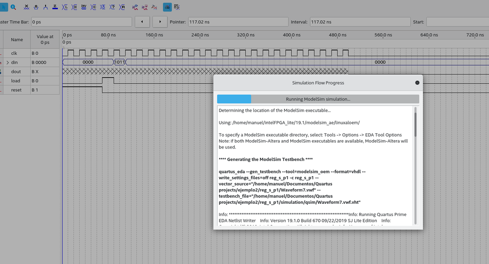

Quartus Prime Lite 19.1 University Program VWF simulation error
Hello everyone, I have installed Quartus in debian, and when I simulate in "University Program VWF" it gets stuck and does not finish the process. The truth is that I have no idea how to solve it, please I need help.
Determining the location of the ModelSim executable...
Using: /home/manuel/intelFPGA_lite/19.1/modelsim_ae/linuxaloem/
To specify a ModelSim executable directory, select: Tools -> Options -> EDA Tool Options
Note: if both ModelSim-Altera and ModelSim executables are available, ModelSim-Altera will be used.
**** Generating the ModelSim Testbench ****
quartus_eda --gen_testbench --tool=modelsim_oem --format=vhdl --write_settings_files=off reg_s_p1 -c reg_s_p1 --vector_source="/home/manuel/Documentos/Quartus projects/ejemplo2/reg_s_p1/Waveform7.vwf" --testbench_file="/home/manuel/Documentos/Quartus projects/ejemplo2/reg_s_p1/simulation/qsim/Waveform7.vwf.vht"
Info: *******************************************************************Info: Running Quartus Prime EDA Netlist Writer Info: Version 19.1.0 Build 670 09/22/2019 SJ Lite Edition Info: Copyright (C) 2019 Intel Corporation. All rights reserved. Info: Your use of Intel Corporation's design tools, logic functions Info: and other software and tools, and any partner logic Info: functions, and any output files from any of the foregoing Info: (including device programming or simulation files), and any Info: associated documentation or information are expressly subject Info: to the terms and conditions of the Intel Program License Info: Subscription Agreement, the Intel Quartus Prime License Agreement, Info: the Intel FPGA IP License Agreement, or other applicable license Info: agreement, including, without limitation, that your use is for Info: the sole purpose of programming logic devices manufactured by Info: Intel and sold by Intel or its authorized distributors. Please Info: refer to the applicable agreement for further details, at Info: https://fpgasoftware.intel.com/eula. Info: Processing started: Mon Mar 18 01:01:27 2024Info: Command: quartus_eda --gen_testbench --tool=modelsim_oem --format=vhdl --write_settings_files=off reg_s_p1 -c reg_s_p1 --vector_source="/home/manuel/Documentos/Quartus projects/ejemplo2/reg_s_p1/Waveform7.vwf" --testbench_file="/home/manuel/Documentos/Quartus projects/ejemplo2/reg_s_p1/simulation/qsim/Waveform7.vwf.vht"Warning (18236): Number of processors has not been specified which may cause overloading on shared machines. Set the global assignment NUM_PARALLEL_PROCESSORS in your QSF to an appropriate value for best performance.
Completed successfully.
**** Generating the functional simulation netlist ****
quartus_eda --write_settings_files=off --simulation --functional=on --flatten_buses=off --tool=modelsim_oem --format=vhdl --output_directory="/home/manuel/Documentos/Quartus projects/ejemplo2/reg_s_p1/simulation/qsim/" reg_s_p1 -c reg_s_p1
Info: *******************************************************************Info: Running Quartus Prime EDA Netlist Writer Info: Version 19.1.0 Build 670 09/22/2019 SJ Lite Edition Info: Copyright (C) 2019 Intel Corporation. All rights reserved. Info: Your use of Intel Corporation's design tools, logic functions Info: and other software and tools, and any partner logic Info: functions, and any output files from any of the foregoing Info: (including device programming or simulation files), and any Info: associated documentation or information are expressly subject Info: to the terms and conditions of the Intel Program License Info: Subscription Agreement, the Intel Quartus Prime License Agreement, Info: the Intel FPGA IP License Agreement, or other applicable license Info: agreement, including, without limitation, that your use is for Info: the sole purpose of programming logic devices manufactured by Info: Intel and sold by Intel or its authorized distributors. Please Info: refer to the applicable agreement for further details, at Info: https://fpgasoftware.intel.com/eula. Info: Processing started: Mon Mar 18 01:01:28 2024Info: Command: quartus_eda --write_settings_files=off --simulation=on --functional=on --flatten_buses=off --tool=modelsim_oem --format=vhdl --output_directory="/home/manuel/Documentos/Quartus projects/ejemplo2/reg_s_p1/simulation/qsim/" reg_s_p1 -c reg_s_p1Warning (18236): Number of processors has not been specified which may cause overloading on shared machines. Set the global assignment NUM_PARALLEL_PROCESSORS in your QSF to an appropriate value for best performance.Info (204019): Generated file reg_s_p1.vho in folder "/home/manuel/Documentos/Quartus projects/ejemplo2/reg_s_p1/simulation/qsim//" for EDA simulation toolInfo: Quartus Prime EDA Netlist Writer was successful. 0 errors, 1 warning Info: Peak virtual memory: 1101 megabytes Info: Processing ended: Mon Mar 18 01:01:28 2024 Info: Elapsed time: 00:00:00 Info: Total CPU time (on all processors): 00:00:00
**** Generating the ModelSim .do script ****
/home/manuel/Documentos/Quartus projects/ejemplo2/reg_s_p1/simulation/qsim/reg_s_p1.do generated.
**** Running the ModelSim simulation ****
/home/manuel/intelFPGA_lite/19.1/modelsim_ae/linuxaloem//vsim -c -do reg_s_p1.do

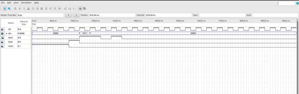

  • Mnauel13's avatar
    Mnauel13
    1. The first error I couldn't fix so I left it for a couple of days, then I restarted the machine and I had the debian operating system for updates, so I did it; after updating and opening quartus I got another error:
    2.Now the problem was to add i386 architecture, also Install libX11.so.6, libxext6:i386, libxft2:i386 library; and the error is this:
    Determining the location of the ModelSim executable... Using: /home/manuel/intelFPGA_lite/19.1/modelsim_ase/linuxaloem/ To specify a ModelSim executable directory, select: Tools -> Options -> EDA Tool Options Note: if both ModelSim-Altera and ModelSim executables are available, ModelSim-Altera will be used. **** Generating the ModelSim Testbench **** quartus_eda --gen_testbench --tool=modelsim_oem --format=vhdl --write_settings_files=off reg_s_p21 -c reg_s_p21 --vector_source="/home/manuel/Documentos/reg_s_p21/Waveform5.vwf" --testbench_file="/home/manuel/Documentos/reg_s_p21/simulation/qsim/Waveform5.vwf.vht" Info: *******************************************************************Info: Running Quartus Prime EDA Netlist Writer Info: Version 19.1.0 Build 670 09/22/2019 SJ Lite Edition Info: Copyright (C) 2019 Intel Corporation. All rights reserved. Info: Your use of Intel Corporation's design tools, logic functions Info: and other software and tools, and any partner logic Info: functions, and any output files from any of the foregoing Info: (including device programming or simulation files), and any Info: associated documentation or information are expressly subject Info: to the terms and conditions of the Intel Program License Info: Subscription Agreement, the Intel Quartus Prime License Agreement, Info: the Intel FPGA IP License Agreement, or other applicable license Info: agreement, including, without limitation, that your use is for Info: the sole purpose of programming logic devices manufactured by Info: Intel and sold by Intel or its authorized distributors. Please Info: refer to the applicable agreement for further details, at Info: https://fpgasoftware.intel.com/eula. Info: Processing started: Tue Mar 26 16:55:11 2024Info: Command: quartus_eda --gen_testbench --tool=modelsim_oem --format=vhdl --write_settings_files=off reg_s_p21 -c reg_s_p21 --vector_source=/home/manuel/Documentos/reg_s_p21/Waveform5.vwf --testbench_file=/home/manuel/Documentos/reg_s_p21/simulation/qsim/Waveform5.vwf.vhtWarning (18236): Number of processors has not been specified which may cause overloading on shared machines. Set the global assignment NUM_PARALLEL_PROCESSORS in your QSF to an appropriate value for best performance. Completed successfully. **** Generating the functional simulation netlist **** quartus_eda --write_settings_files=off --simulation --functional=on --flatten_buses=off --tool=modelsim_oem --format=vhdl --output_directory="/home/manuel/Documentos/reg_s_p21/simulation/qsim/" reg_s_p21 -c reg_s_p21 Info: *******************************************************************Info: Running Quartus Prime EDA Netlist Writer Info: Version 19.1.0 Build 670 09/22/2019 SJ Lite Edition Info: Copyright (C) 2019 Intel Corporation. All rights reserved. Info: Your use of Intel Corporation's design tools, logic functions Info: and other software and tools, and any partner logic Info: functions, and any output files from any of the foregoing Info: (including device programming or simulation files), and any Info: associated documentation or information are expressly subject Info: to the terms and conditions of the Intel Program License Info: Subscription Agreement, the Intel Quartus Prime License Agreement, Info: the Intel FPGA IP License Agreement, or other applicable license Info: agreement, including, without limitation, that your use is for Info: the sole purpose of programming logic devices manufactured by Info: Intel and sold by Intel or its authorized distributors. Please Info: refer to the applicable agreement for further details, at Info: https://fpgasoftware.intel.com/eula. Info: Processing started: Tue Mar 26 16:55:12 2024Info: Command: quartus_eda --write_settings_files=off --simulation=on --functional=on --flatten_buses=off --tool=modelsim_oem --format=vhdl --output_directory=/home/manuel/Documentos/reg_s_p21/simulation/qsim/ reg_s_p21 -c reg_s_p21Warning (18236): Number of processors has not been specified which may cause overloading on shared machines. Set the global assignment NUM_PARALLEL_PROCESSORS in your QSF to an appropriate value for best performance.Info (204019): Generated file reg_s_p21.vho in folder "/home/manuel/Documentos/reg_s_p21/simulation/qsim//" for EDA simulation toolInfo: Quartus Prime EDA Netlist Writer was successful. 0 errors, 1 warning Info: Peak virtual memory: 1101 megabytes Info: Processing ended: Tue Mar 26 16:55:12 2024 Info: Elapsed time: 00:00:00 Info: Total CPU time (on all processors): 00:00:00 Completed successfully. **** Generating the ModelSim .do script **** /home/manuel/Documentos/reg_s_p21/simulation/qsim/reg_s_p21.do generated. Completed successfully. **** Running the ModelSim simulation **** /home/manuel/intelFPGA_lite/19.1/modelsim_ase/linuxaloem//vsim -c -do reg_s_p21.do /home/manuel/intelFPGA_lite/19.1/modelsim_ase/linuxaloem//vish: error while loading shared libraries: libX11.so.6: cannot open shared object file: No such file or directory Error.
    su
    dpkg -add-architecture i386
    apt-get update
    apt-get dist-upgrade
    apt-get -f install
    apt-get clean
    and that's it, it seriously took me two weeks to fix this problem.
