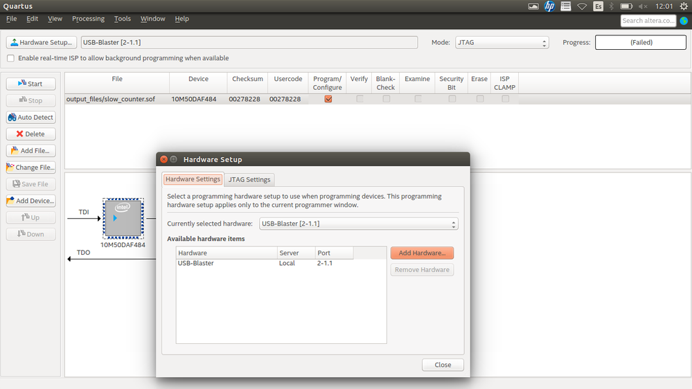

Quartus 17 can't programm DE10 Lite on Ubuntu 16
I have installed Quartus 17 on Ubuntu 16.04 and the problem is that after select USB-Blaster and Trying to upload the programm to the DE10 Lite, always get FAILED. I was working with a EP1C3T144 but just in Windows, using Quartus 10, at that time Ubuntu never recognized USB-Blaster. Now I don't know if I forgot to install something, for the installation of Quartus, I did:

    Ok, finally I found a way to programm my FPGA DE10 Lite, and I as thougth it was due to some libraries in Ubuntu. The line in a terminal to check my problem is the next:
    $ /.../quartus/bin/jtagconfig
    1) USB-Blaster [1-3]
    Unable to read device chain - JTAG chain broken
    So with the next commands :
    $sudo apt-get install libudev1:i386
    $ sudo ln -sf /lib/x86_64-linux-gnu/libudev.so.1 /lib/x86_64-linux-gnu/libudev.so.0
    Then I checked again :
    031050DD 10M50DA(.|ES)/10M50DC
    Finally on Quartus, I run programmer and started and I got : Sucessful
