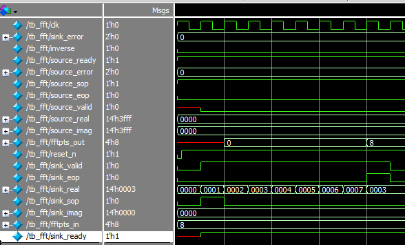

Dear All,
I am trying to simulate the FFT IP core. I would like to ask for some advice on how to proceed and how to compare the output from the simulation with Matlab. Please find the procedure I have followed, the results, and the main logic from the testbench below.
- altera FFT IP core
- length: 8.
- input/output Order: Natural
- Data flow: Variable Streaming.
- Representation: Fixed Point.
- Data input width: 14 bit.
- Twiddle Width: 14 bit.
- Data output Width: 14 bit.
My testbench logic to test input data:
task fft_data;
integer i;
reg [13:0] test_data [0:7];
begin
data[0] = 14'd1;
data[1] = 14'd2;
data[2] = 14'd3;
data[3] = 14'd4;
data[4] = 14'd5;
data[5] = 14'd6;
data[6] = 14'd7;
data[7] = 14'd3;
for (i = 0; i < 8; i = i + 1) begin
@(posedge clk);
sink_real <= data[i];
sink_imag <= 14'd0;
sink_valid <= 1;
if (i == 0)
sink_sop <= 1;
else
sink_sop <= 0;
if (i == 7)
sink_eop <= 1;
else
sink_eop <= 0;
end
@(posedge clk);
sink_valid <= 0;
sink_sop <= 0;
sink_eop <= 0;
end
endtask
Matlab, after I created the FFT example design, I have the following results:
test data => x = [1, 2, 3, 4, 5, 6, 7, 3];
>> fft_ii_0_example_design_model
ans =
31.0000 + 0.0000i -8.0000 + 6.0000i -4.0000 - 1.0000i 0.0000 - 2.0000i 1.0000 + 0.0000i 0.0000 + 2.0000i -4.0000 + 1.0000i -8.0000 - 6.0000i
- What am I missing, and how should I proceed with simulation and debugging?
- Also, the calculation latency for the specific IP is 8, and the throughput latency is 16. Does that mean I should expect the source_real output after 16 cycles for each data input?
- Can you let me know if i can use for simulation the files on photo whaich are auto generated files from FFT IP core example design.
Thank you.

Sorry for the late reply.
You can follow the guidance in FFT IP User Guide to simulate the FFT model in Matlab:
The Matlab model locate at: <IP_variation_directory>/<altera_fft_ii>/sim/Matlab_model/
