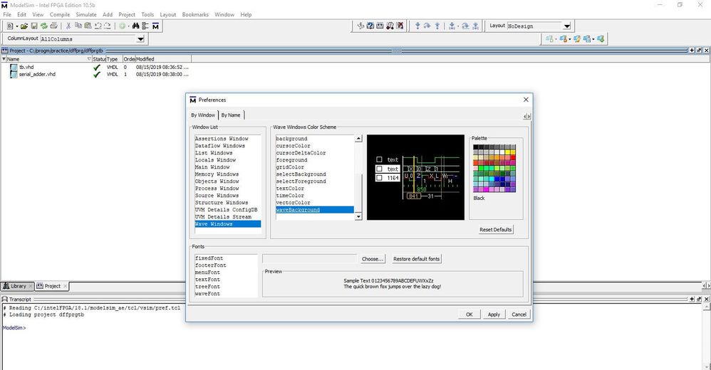

  • Vicky1's avatar
    Vicky1
    Could you please check under 'Tools' -> 'Edit Preferences..' option....
    Please refer the screenshot below,

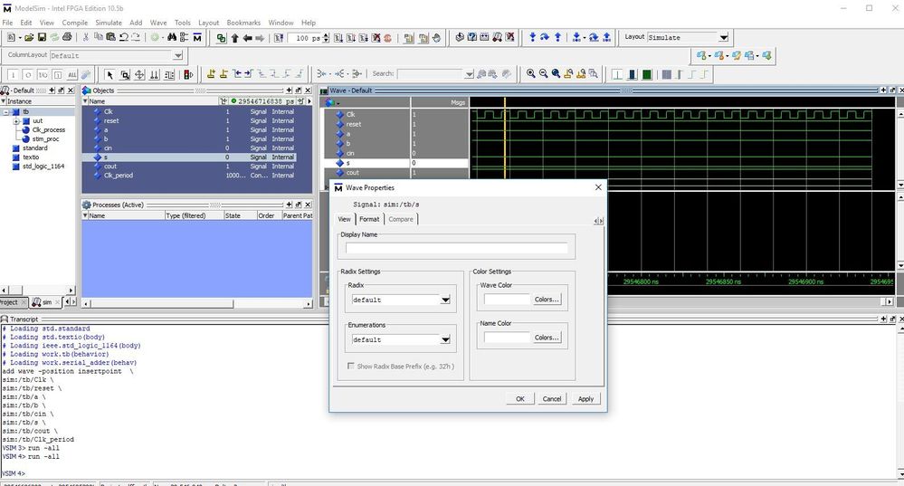

  • Vicky1's avatar
    Vicky1
    It may not be available, wave color & name color settings are available in wave properties.
    please refer the below screenshot,
