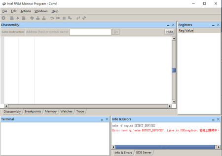

intel FPGA Monitor Program can't work
- 4 years ago
I found the answer.
First, I saw the command, make, and I tried to install make.exe for windows.
However, it still doesn't work.
Then, I finally know how it is. I realize Quartus lite 21.1 needs WSL1.
The pdf, Intel FPGA Monitor Program Tutorial for ARM*, even do not mention WSL1.
please configure this one.
Sincerely,
Triven
No,
Just the error message in the first post.
BTW, I was following the pdf, Intel FPGA Monitor Program Tutorial for ARM*.
Please help me
Sincerely,
Triven
I found the answer.
Sincerely,
Triven
