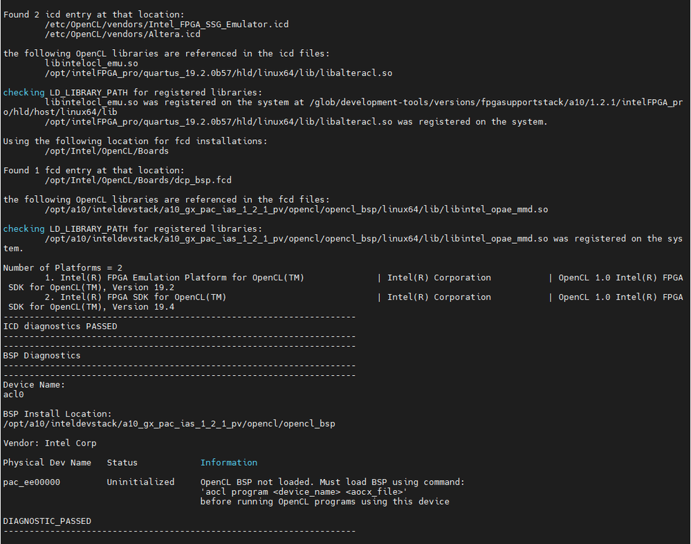

Later, when trying "aocl diagnose", this was shown in the prompt, indicating a successful initialization:

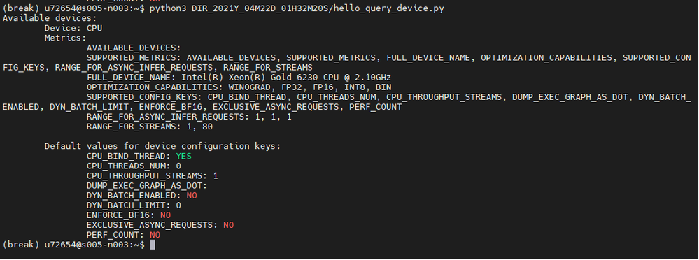

However, when running "hello_query_device.py" from OpenVino, the output shows only a CPU device:

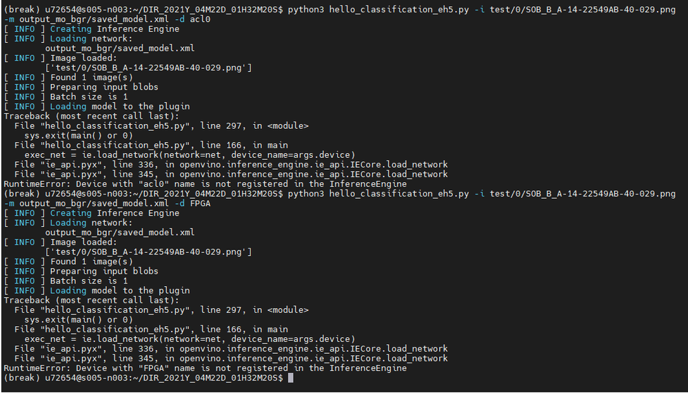

When I ran the "hello_classification.py" example with "-d FPGA" flag for inference, I keep getting this error, which I believe is due to the lack of "FPGA" under "aocl diagnose":
My question: Should it shows another "Device: FPGA" below "Device: CPU"?
