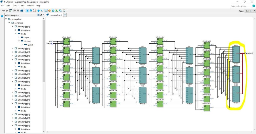

I attached the code for array of pipeline d flipflop please give suggestions to rectify the synthesis error in the code .

    Hi Latha,
    Here Net out[2],out[1],out[0] are driving by more than one source & that too direct wiring and that is not recommended, refer the RTL viewer.
    If you want to do so you need to write priority logic for corresponding node(like multiplexer).
