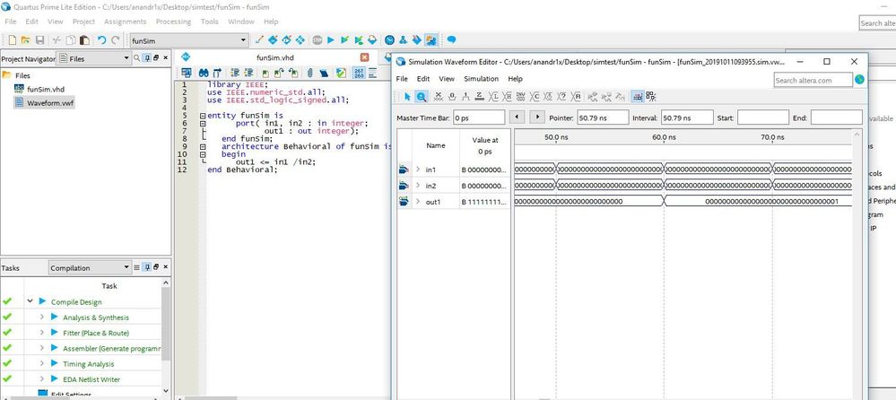

    1. Delete db, incremental_db and simulation folder from the project directory.
    2. Run a full compilation of the Quartus project.
    3. Include the numeric library.
    Anand
