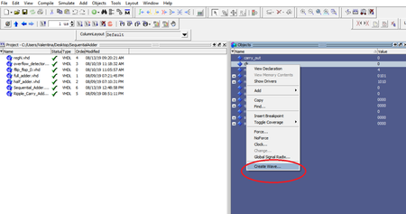

7 years agoHi, I tried to apply the stimuli using modelsim to the sequential adder that I described in vhdl. In particular:
1) I tried to generate the clock signal like this (with create wave): here is the screenshot: But doing so it does not work, num1 is the first number to be added num2 is the second number s, ...

Thanks for the details.
Why don`t you use latest Free Quartus(Lite) & Modelsim starter versions?
http://fpgasoftware.intel.com/18.1/?edition=lite&platform=windows&download_manager=dlm3&product=modelsim_ae#tabs-2
I would like to suggest you, try at your end with latest versions also as mentioned vector waveform in previous post.
I am looking forward to listen you.
Vicky
MPitt3
7 years agoThanks a lot !!
I solved, the result is now correct as you can see from the photo with the new version of the software !! We see that the old version had some problems ... thanks again really
