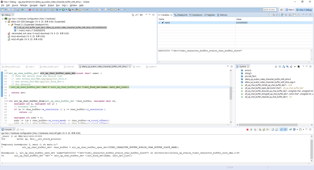

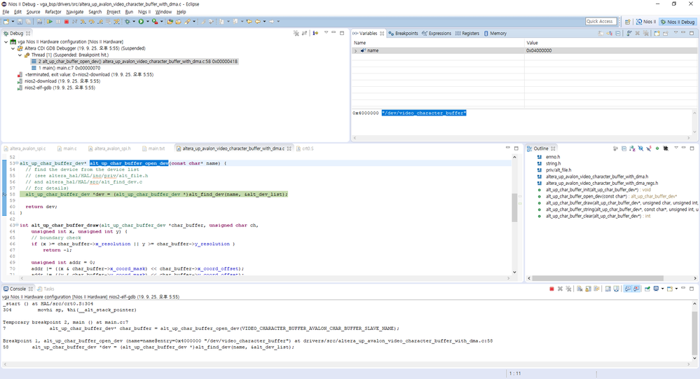

I wrote the following code:
alt_up_char_buffer_dev* char_buffer = alt_up_char_buffer_open_dev(VIDEO_CHARACTER_BUFFER_AVALON_CHAR_BUFFER_SLAVE_NAME);When I compile this code with -O0, the return value was NULL.
When I compile this code with -O2, the return value was pointer of (correct) device structure.

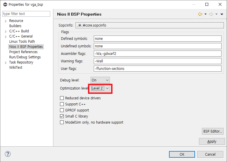

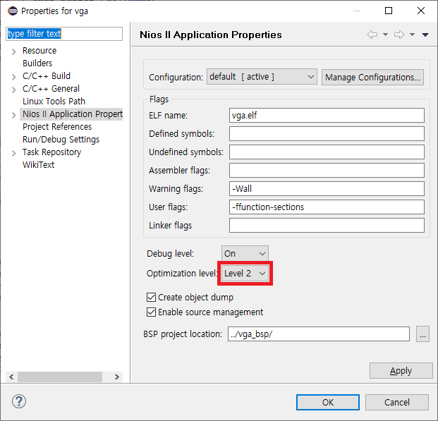

4. Would you mind to further elaborate on what is referred by "compile this code with -O0 or -O2"?

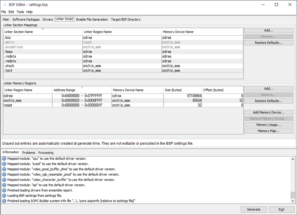

#include <stdlib.h> #include "system.h" #include "altera_up_avalon_video_character_buffer_with_dma.h" int main() { alt_up_char_buffer_dev* char_buffer = alt_up_char_buffer_open_dev(VIDEO_CHARACTER_BUFFER_AVALON_CHAR_BUFFER_SLAVE_NAME); if (char_buffer == NULL) return EXIT_FAILURE; alt_up_char_buffer_string(char_buffer, "Hello, world!", 0, 0); }To avoid using pixel memory as code/data area, I modified some BSP configuration related to linker script.
When I use Level 2 optimization, name parameter inside alt_up_char_buffer_open_dev function is "/dev/video_character_buffer".
The parameter the caller site was VIDEO_CHARACTER_BUFFER_AVALON_CHAR_BUFFER_SLAVE_NAME, which was string literal "/dev/video_character_buffer_avalon_char_buffer_slave".
The return value is correct device descriptor.
When I use Optimization Off, name parameter inside alt_up_char_buffer_open_dev function is "/dev/video_character_buffer_avalon_char_buffer_slave".
The return value is NULL.

4) I meant "Optimization Level" here. "-O2" means "Level 2", and "-O0" means "Off".
