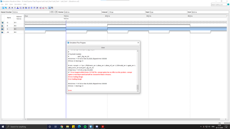

I was trying to use the Simulation Waveform Editor but I get an error when I try to run simulation.
I have attached a screenshot of the error
Could you please help me out
Thank you

Hi Vishvas,
Remove the -novopt in your script and rerun the simulation.

5 years agoHi Vishvas,
Vishvas
5 years agoThank you that issue is resolved.
Now I'm facing a new problem. I get an error saying :
Error (suppressible): (vsim-3601) Iteration limit 5000 reached at time 25 ns.
I am trying to simulate a simple RS Latch. My code is below and I have attached the screenshot of the error as well. I tried searching how to resolve this error. I read this can occur when there is an infinite loop, but I'm not sure how my code can end up in such a loop. Am I doing something wrong? I'm kinda new to Quartus as well
module part1(clk, R, S, Q); input clk, R, S; output Q; wire R_g, S_g, Qa, Qb /* synthesis keep */; and(R_g, R, clk); and(S_g, S, clk); nor(Qa, R_g, Qb); nor(Qb, S_g, Qa); assign Q = Qa; endmodule
