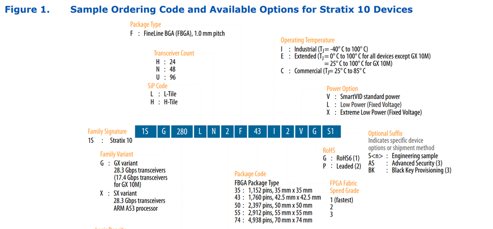

Hi duyhung3286,
The Stratix 10 GX and SX are different family variants, which you can explore further in the device overview's OPN (Stratix® 10 GX/SX Device Overview).
Additionally, here’s the datasheet covering all variants (Intel® Stratix® 10 Device Datasheet).
Fakhrul
