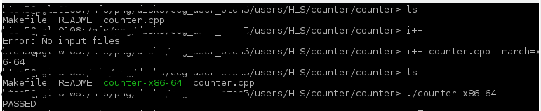

But I am not able to access HLS , please help me in this regard.
Attatchment: The screenshot of the command prompt is attached.

Based on the screenshot provided, it does seems that the initialization has been done with some minor complain on quartus not found.
However the i++ command should be working, the error in the screenshot seems to be complaining about the missing param. You can run the i++ -help command to check on the required param and also refer to the link below to run some example design that comes with HLS.

As mention earlier after setting up the environment and required library, just by running the i++ command if not sufficient as you would need to mention the required param.
Would suggest to go to the example design that comes with the installation under the path <hls installation path>/hls/examples.
From there you can compile the .cpp code via the command below:
- i++ counter.cpp -march=x86-64 -o counter-x86-64

- MPH23
Thank you for your support
I have tried to create the HLS environment a lot in Quartus 19.1 Standard Edition but couldn't then I installed Quartus 23.1 Standard Edition where I am able to create the HLS environment through the command prompt and had executed the QRD example which is already present in the HLS installation.Now I want to know that at present I have execute the examples that are already present but if I want to create my own HLS file in which software I will build or how I will build the .cpp and .h and verify or debug my code as I have seen the HLS is executing directly from the command prompt, it is not opening as an interface where I can write my HLS code as like I can write the VHDL or Verilog code in the Quartus interface but I have not found any interface for HLS.Attachment: Execution of the QRD ExamplePlease help me in this regard.Thanking you
