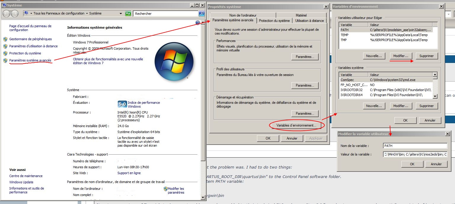

    Just wanted to mention that these steps worked for the DE4 board too. No need to download the .sof before launching the control panel, though.
    Attached you can find how to add a path to the variable, just use a semicolon ; to add a new path to the existent.
