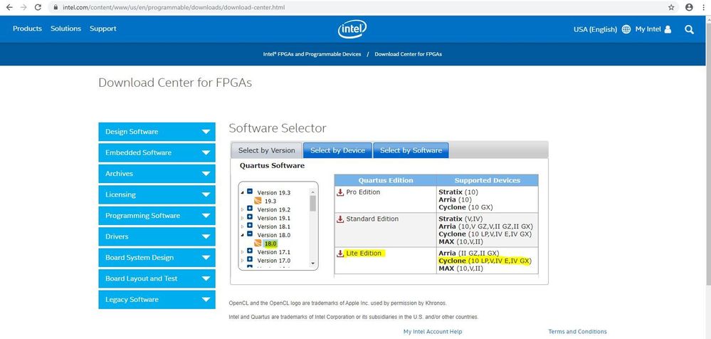

6 years agoCan I program the CD0-CV with quartus prime lite version 18
- Vicky1
You can check Q18.0 Lite supported devices families using link below,
https://www.intel.com/content/www/us/en/programmable/downloads/download-center.html
