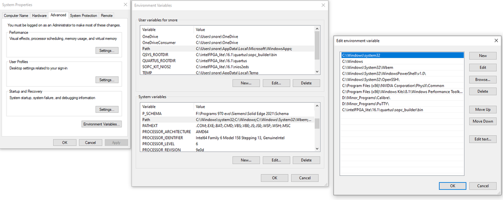

Hi Patrick77

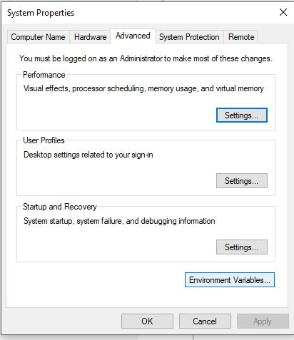

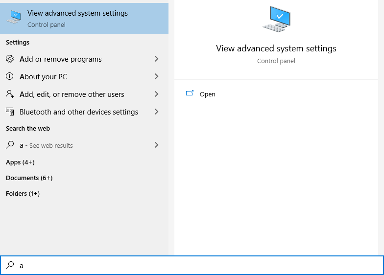

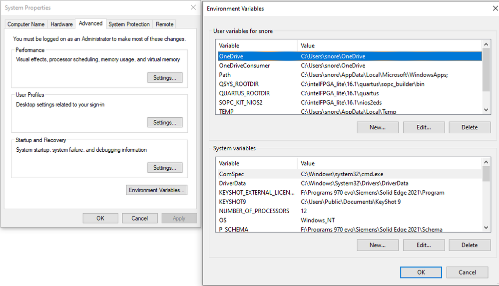

Permanent solution:Go to advanced system settings:
Click on Environment Variables...:

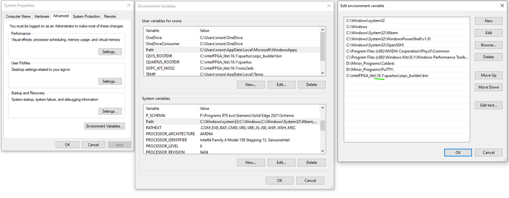

And in "System variables" double click "Path" variable:
And replace the version number in the quortus line (don't forget to change the directory name if youre using a standard quortus version or pro version. Mine is lite):

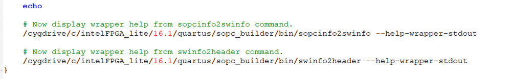

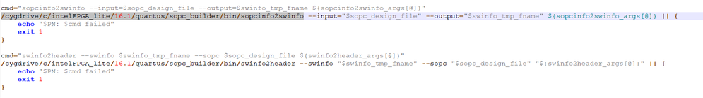

You need to edit file:
C:\intelFPGA_lite\16.1\quartus\sopc_builder\bin\sopc-create-header-files
You need to edit lines with swinfo2header and sopcinfo2swinfo.
Add:
/cygdrive/c/intelFPGA_lite/16.1/quartus/sopc_builder/bin/
before swinfo2header and sopcinfo2swinfo.
It should be something like this:
/cygdrive/c/intelFPGA_lite/16.1/quartus/sopc_builder/bin/swinfo2header/cygdrive/c/intelFPGA_lite/16.1/quartus/sopc_builder/bin/sopcinfo2swinfo
