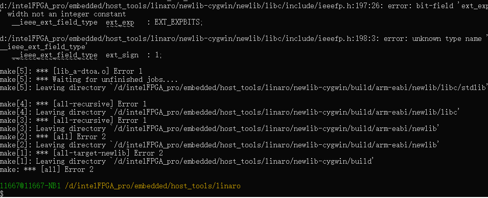

I deployed the FPGA test environment on Windows10 based on the Intel SoC FPGA Embedded Development Suite (SoC EDS) User Guide,.However, I encountered a problem when installing Linaro Bare Metal Toolchain. I executed the install_linaro.sh script but it failed. The following compile error has occurred.Any feedback or suggestions are welcome.

I faced a similar error while trying to install Linaro on Windows. You could try the fix given here: https://github.com/altera-opensource/intel-socfpga-hwlib/issues/1
Just remember to delete any files that were installed by the script before trying again (i.e. everything except install_linaro.sh if I remember correctly). You can change the line endings by running "$ git config --global core.autocrlf input" in the Msys terminal
