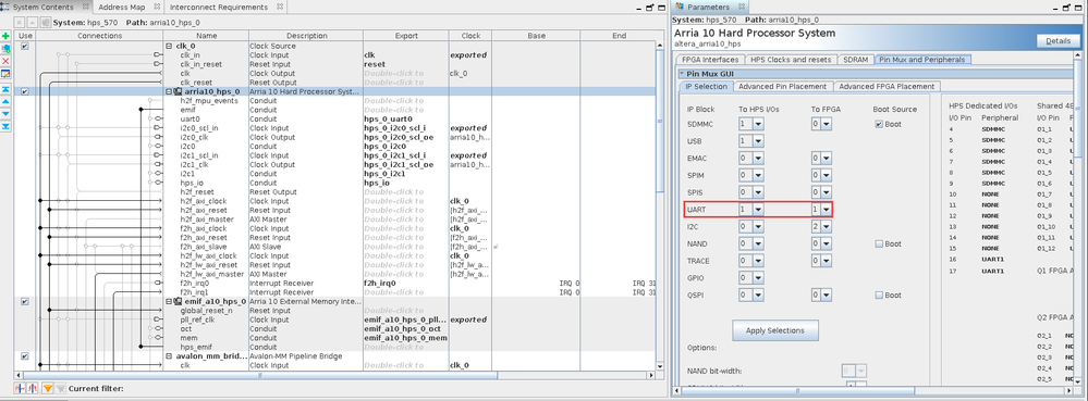

In out case, HPS UART0 is routed to FPGA, HPS UART1 is routed to HPS.

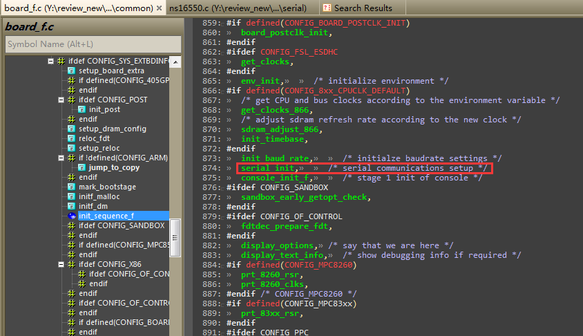

But we found that uboot would hanging while HPS UART0 initializing(before HPS UART0 initialize, HPS UART1 finished initialzing).
The problem is hanging in ns16550.c
while (!(serial_in(&com_port->lsr) & UART_LSR_TEMT))
;Is there anything we missed if we are making the HPS UART route to FPGA or any change we should make in uboot?

May I know which quartus version you are using?
Have you tried running our GHRD image to see if everything works successfully?
You may find the steps here:
https://rocketboards.org/foswiki/Documentation/A10GSRDBootLinuxFromSDCardLTS
For Quaruts version 18.1 you may find the image here:
https://rocketboards.org/foswiki/Documentation/GSRD181ReleaseNotes
