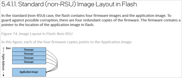

      Can you please confirm SDM will try the next copy when using a non-RSU layout, like the one shown here (so, there is just "Firmware", not "decision firmware"):
      https://www.intel.com/content/www/us/en/docs/programmable/683673/23-3/standard-non-rsu-image-layout-in-flash.html

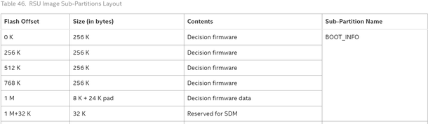

      The docs for a different device (Stratix 10) shows 256KB slots 5.4.2.1. RSU Image Sub-Partitions Layout (intel.com)

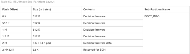

      But for Agilex 7, 5.4.2.1. RSU Image Sub-Partitions Layout (intel.com) shows 512KB slots:

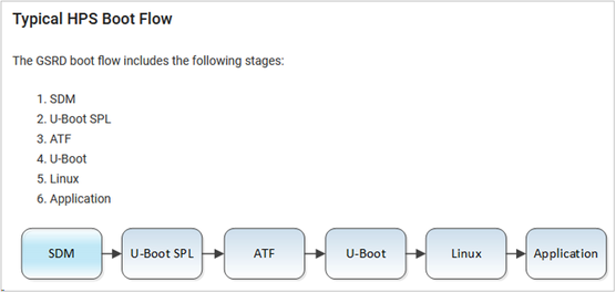

      The initial 4 steps in my boot flow resemble the following:
      https://www.rocketboards.org/foswiki/Documentation/AgilexSoCGSRD#Writing_JIC_Image_to_QSPI_Flash

    Regarding the size of the image, I think you maybe right when looking at the comparison between agilex7 and Stratix10 which tells why you have erase with 0x80000. However I think both RSU or non-RSU from having the same flash layout whereby the BOOT_INFO contains the same 4 decision firmwares where it is stored/located starting from address 0x00000000 of the QSPI flash.
