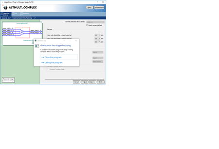

7 years agoWhy am I getting "clearbox.exe has stopped working" when I run the ALTMULT_COMPLEX Megawizard?
Running both Quartus 18.0 and 18.1 (both lite) on Windows 10 - when I start the wizard clearbox.exe popups up a stopped working. The wizard UI runs through but isn't generating the files correct...

5 years agoHello I am facing exactly (!) the same problem. I am using a "DE2-115" board together with the "Quartus 18.1.1 Build 646 SJ Lite Edition" on a "Win8.1prof" installation.
Has a solution to this been found in the meantime?
- JanSch5 years ago
A reinstallation solved the problem (... before that uninstall and delete all remaining registry keys and file relics).
