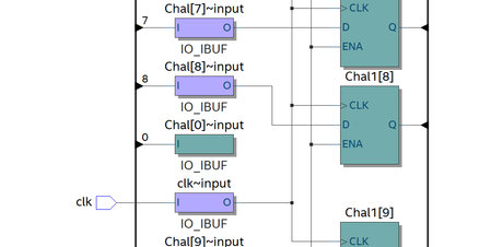

Warning: Design contains 1 input pin(s) that do not drive logic

Thank you sstrell,
Even this is not making any difference in technology map viewer. Its shows the same warning.
Actually, my logic goes in this way,
1.As posedge of clock pulse, once trig_signal is enabled , i need to make arb module to function .
2. The first loop will have the input as trig_reg and Chal(o). [ Note: I used Chal1 just to verify whether the technology map viewer considers Chal[0] inside the loop]
3. The output of the first loop will be given to sec ond loop along with Chal[1].
The problem which I am facing is LOOP (0) is not getting the Chal(0) signal inside the block so the whole loop will not functiom.Actually , this code is a part of my module.
So, now I need to connect my Chal(0) inside my block. Thank you in advance.
