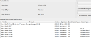

10 months agoWarning (292000): FLEXlm software error: Version of vendor daemon is too old. Feature: 6AF7_018C
I get the following error when trying to synthesize a design containing a NiosV in Quartus Prime 24.1std.0: Warning (292000): FLEXlm software error: Version of vendor daemon is too old. Feature: 6AF...
stuetz
10 months agoHi,
I solved the issue. I realized that lmgrd and alterad where located in a different folder then C:\flexlm
Replacing both files with the new version you linked above, the output of lmstat is as expected:
XXXX: license server UP (MASTER) v11.19.6
Vendor daemon status (on XXXX):
alterad: UP v11.19.6
Thanks!
