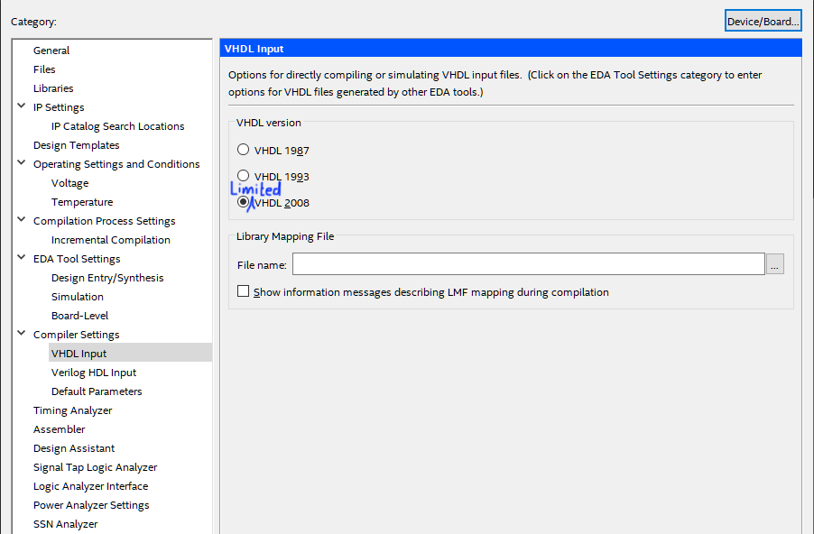

Are there any other options that I need to select in Quartus to enable proper compilation of IEEE Std 1076-2008?--- -- -- Intel Quartus Pro edition has full support for VHDL-2008, Intel Quartus Standard has limited support, please refer the Page-7 from link below & check your Quartus edition.
https://www.intel.com/content/dam/www/programmable/us/en/pdfs/literature/br/br-quartus-prime-software.pdf

Ah, I see!
Do you have a compliance/non-compliance list?
- Vicky16 years ago
There is no proper compliance available yet & you may find discrepancy in document. In Intel Quartus prime Pro support for VHDL-2008 as follows,
https://www.intel.com/content/www/us/en/programmable/quartushelp/current/index.htm#hdl/vhdl/vhdl_list_2008_vhdl_support.htm
should I consider that case to be close.
Vicky
