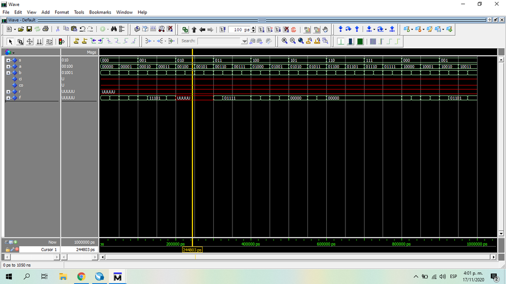

"UUU" output in ModelSim on a specific output
Cordial greetings, your help has served me well. I have this situation:
I am making an ALU that adds, subtracts, multiplies (3X2 bits), and does logical operations. For this, I use the libraries "IEEE.std_logic_arith.all", "IEEE.std_logic_unsigned.all" and "IEEE.numeric_std.all"; I did the multiplier separately, included it in the project, and "invoked" it.
The problem is in the multiplier. The code that I will present to you does compile, however, the RTL simulation (in ModelSim) gives the following answer:
The "UUUUU" output is precisely when s es "010" that is, the multiplier output.
This is the code:
library ieee; use ieee.std_logic_1164.all; use ieee.std_logic_arith.all; use ieee.std_logic_unsigned.all; use ieee.numeric_std.all; entity alu is port( s: in std_logic_vector (2 downto 0); a: in std_logic_vector (4 downto 0); b: in std_logic_vector (4 downto 0); ci: in std_logic; co: out std_logic; r: out std_logic_vector (4 downto 0); f: out std_logic_vector (4 downto 0) ); end alu; architecture comportamiento of alu is component multiplicador port( a: in std_logic_vector (2 downto 0); b: in std_logic_vector (1 downto 0); ci: in std_logic; co: out std_logic; r: out std_logic_vector (4 downto 0) ); end component; signal ri: std_logic_vector (4 downto 0); begin with s select f<= a+b when "000", a-b when "001", ri when "010", a or b when "011", a xor b when "100", a and b when "101", "00000" when others; end comportamiento;
I am very grateful for your help.

The signal
ri
is not connected. A function how to build up the "ri" signal is missing also. So, "ri" is always undefined in all cases.
The output of your multiplier is "r" NOT "ri".
The interfacing to generate the final output stage is wrong. You use a simple multiplexer to switch between the two outputs of "alu" and "multpl." which are running in parallel. This is generally not wrong - but you must know HOW TO before doing such things.
Try to rename the output of the multplier from "r" to "ri" and delete the "signal ri ..." line...It should help (if the multplier was tested before and is functional as intended) to give other results before/while/after simulation to you and to step further like try-and-error.

Good day, thank you very much for your help.
I have to invoke the multiplier with "por map", create a signal that comunicate the multiplier with "alu" inputs and, at the same time, adapt the 5-bit input to the 3X2 bits of the multiplier.
