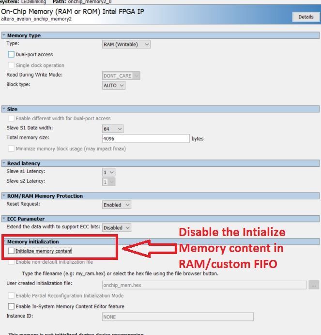

Your error happened because you enable the Initialize memory content in custom FIFO or a RAM block.
The workaround for this error, you need to ensure that the Initialize memory content in custom FIFO or a RAM block is disable (uncheck the Initialize memory content button).
You can refer to picture below (in my design I use RAM).
Thank you.
