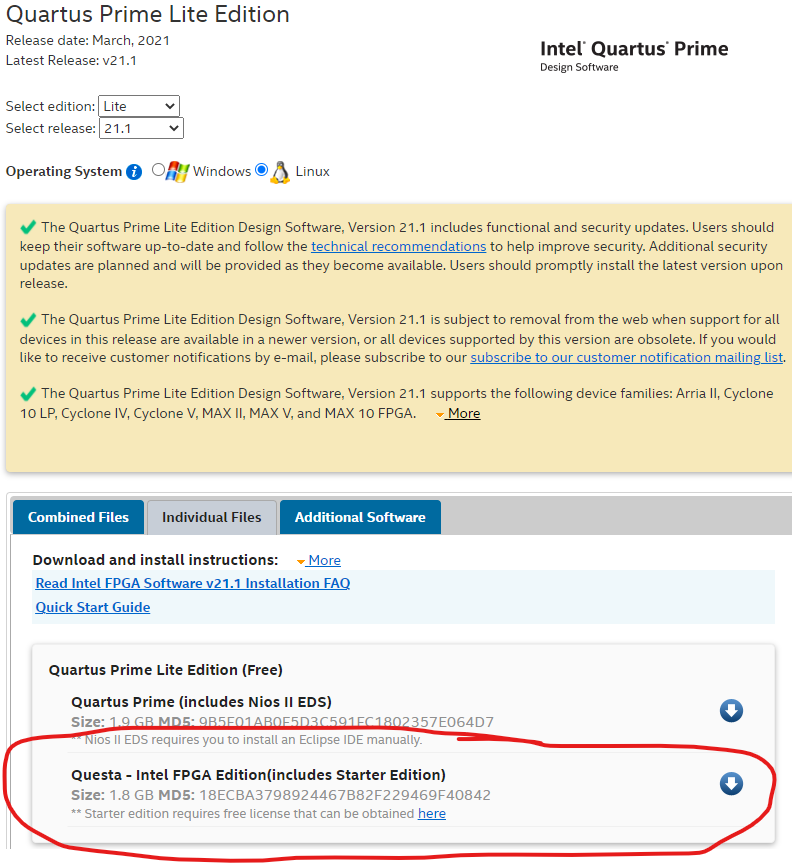

I have downloaded this file:
And installed it.

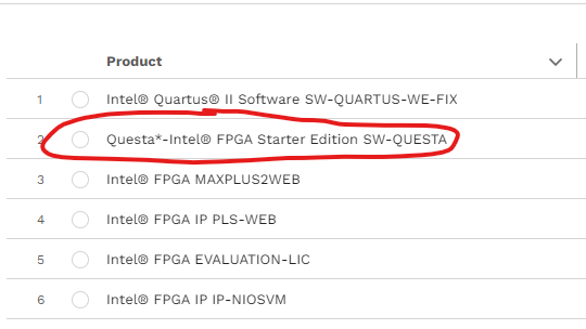

Then, i have generated this license from Intel SSLC:
I have downloaded the license file, renamed it to license.dat and copied it to /usr/local/flexlm/licenses/
