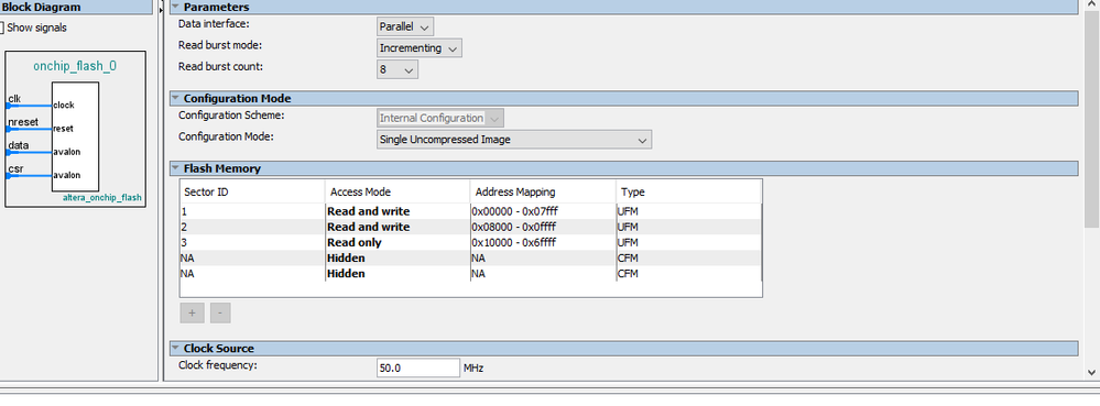

My project i have 3 sector id and starting address of. (max10m40 fpga)
Sector id 1 starting address = 0x0000; and ending address was 0x7fff;
each page of 64kbits what is the ending address of first page and how to calculate.

The picture you are showing will be based on 8bit addressing. So I would recommend you to divide by 8.

Yes. If you using Qsys with Nios then it will be using 8bit addressing. So you need to divide by 8 only which will be 0x2000.
