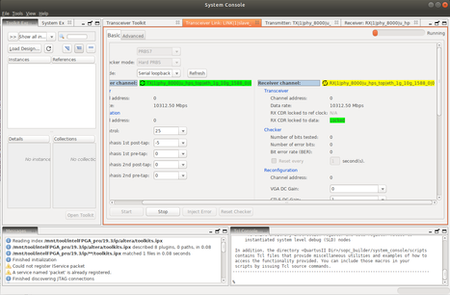

5 years agoThe problem about Transceiver Toolkit for testing IP : altera_xcvr_10gkr_a10
Hi all,
I want to test BER in Transceiver Toolkit for altera_xcvr_10gkr_a10,
In IP Parameter, I choose "Enable Hard PRBS and Native PHY Debug Master Endpoint support"
After compile, in Transce...

Hi
If you can use the Native PHY IP will be a great help to narrow down the problem, you may use the 10G base R preset setting in Native PHY IP and then enable the PHY to debug the master port. This can help to rule out if there is any dependency on the BASR KR IP or any design connection relate problem.
Regards -SK
SengKok_L_Intel
5 years agoHi Sam,
The 10GBase KR PHY IP includes the feature of ethernet standards, when you run the PRBS test, it may cause the receiver to keep resetting.
To run the PHY PRBS test, it will be better if you can use the standalone Native PHY IP and configure it as 10G.
Sam_Chang
5 years agoHi,
So,I enable the HARD PRBS and Native PHY Debug Master Endpoint Support ,
it still can't run PRBS test, right?
THANKS!
