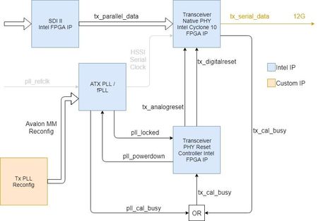

Hello, we’re facing the following problem.
We’re developing the project with SDI 12G output signal on base Cyclone 10 GX FPGA.
We use the Intel IP for SDI protocol, Transceiver PHY and Tx PLL. He...
