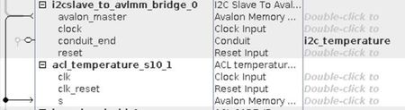

I try to use i2c port to read temperature sensor on s10. I use i2cslave_to_avlmm_bridge to convert i2c signal to avlmm. and connect avlmm to acl_temperature_s10 slave port. However, it's...

8 years agoYes, the diode is in a specific location. You can add a pipeline bridge component from the IP catalog and just attached the master and slave interfaces between the i2c bridge and the TSD appropriately.
