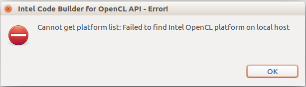

System Studio giving "Failed to find Intel OpenCL platform on local host"
I have an Arria 10 Dev Kit installed on PCIe. What do I have to set up in System Studio for it to find my device? Here's what I can do:
  1. I can run "aocl diagnose" successfully.
  2. I can compile kernels using "aoc" with both emulator and board options.
  3. "aocl list-devices" returns the correct info.
  4. I have a few env vars defined, including AOCL_BOARD_PACKAGE_ROOT and INTELFPGAOCLSDKROOT.
5 Replies
  • okramer's avatar
    okramer

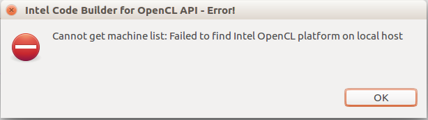

    On opening System Studio, I get:
    Then after closing that message, I get the next one:
    Then finally:
    Here's some info from the shell:
