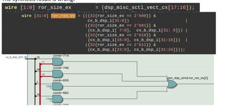

synthesis have a wrong result when some logic in generate block
Hi wsive, today I got again similar issue, I am suspecting some issue by file size and or long comment.
They appear and disappear, few hour ago I got deterministic stable behavior, if elsif generate wrong network, case instead generate ok also cleaning project.
After some change to file removing large commented block issue disappeared and never appeared till now using if elsif was stable errantic.....
From error issue to now the version where wrong now compile fine.
I am using VHDl but I observed some similar issues also on verilog and your file has near 1K lines like mine.
Try add a large code commented block (100 lines or more) before and after and see what happen. No more idea for now, I seen other observe intermittent issue.
thanks for relay. do you mean, I need try to add a large code commented block (100 lines or more) before the generate block and after the generate block?
the commented block may like below:
